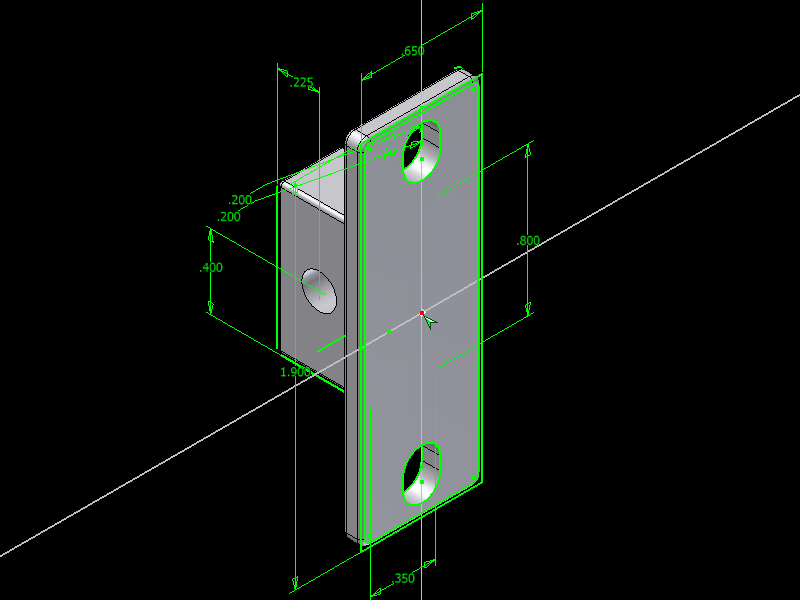

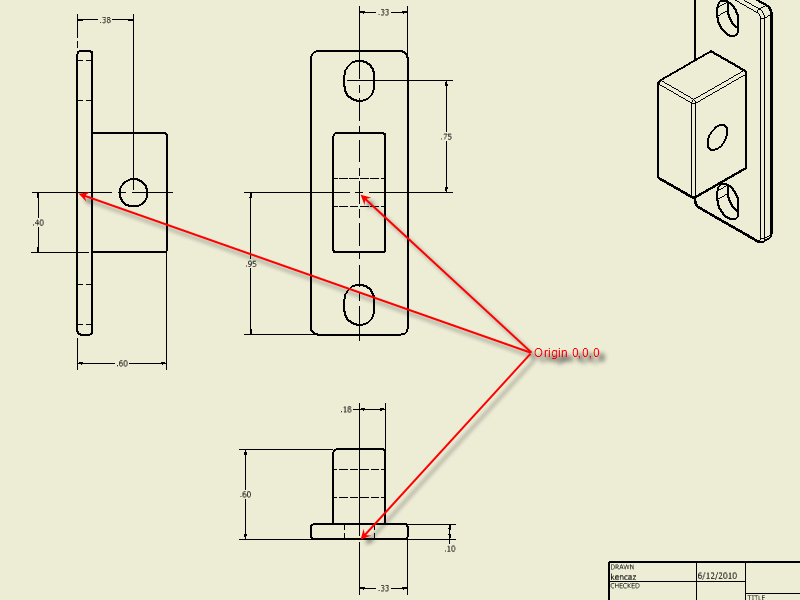

I am using Inventor 2010. Having drawn my geometry and created an extrusion; I would like to create a drawing with all the points dimensioned in absolute X/Y coordinates relative to XY zero for use in programming the geometry into a Prototrak CNC mill. to be keyed in on the shop floor.
I do this now in GibbsCam;but the poor print quality usually requires many drawings for one part.
and my inventor skills are growing;but,i havent seen this in any of the books or tutorials.
thanks for any help
Unlike AutoCAD (where I never draw from absolute 0,0,0 and use relative coordinates), Inventor is different in that I always [well most of the time], draw my sketch profiles with the origin either center or corner depending on what I need to do with it.
That does not really matter, however, for your drawings because you can work off of a center line that can represent your origin point which can be anywhere.

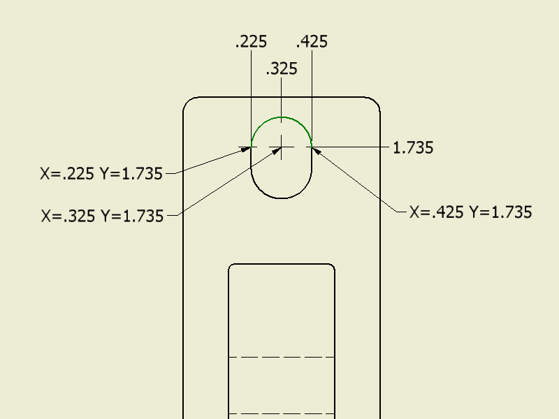

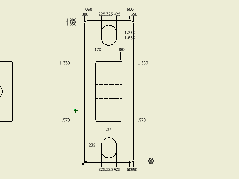

Use Ordinate Dimensions to get X and Y...
I selected the Origin point in the lower left corner.

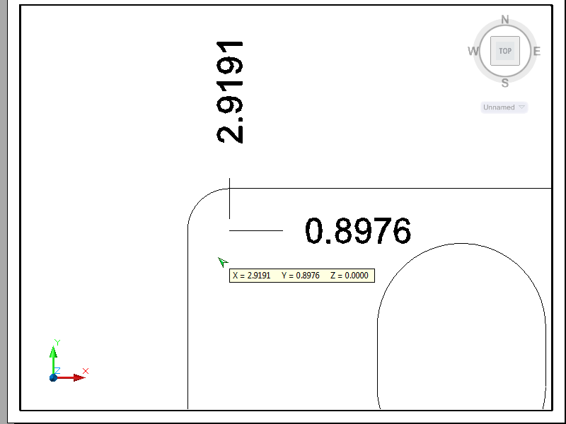

AutoCAD will also do it for you.

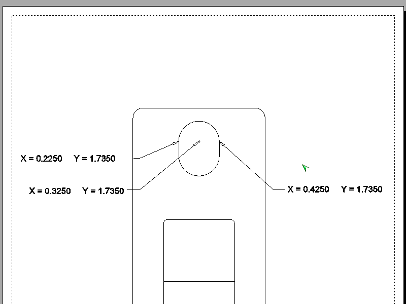

In the last attachment;the little rectangular block with XYZ coordinates.
That is what I am looking for........How do I do that in Inventor 2010 ?
I'm not sure in Inventor and I can't find any information on it either. You can enter the point data manually, however, that would be a lot of points to enter.
It's a little easier in AutoCAD because you can cut and paste the point ID data into leader text.

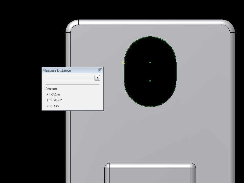

You can get x-y data from your (idw) with the measure command but it gives points from the sheet not the model... I'll see what else I can find.
KC
Well, you can get point data from the model, however, you'll still have to copy it to your drawing. Better then nothing I guess.
