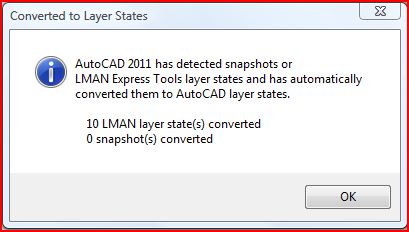

I am also trying to incorporate the delete layer states command of this lisp routine, but it is not getting them all. Any ideas why?
  (if (setq states (layerstate-getnames t t))
   (mapcar (function layerstate-delete) states))

That is what I have, but when I run the lisp, it doesn't get all of the layer states that were created in the drawing that I have.
Me neither, but I have asked around and this seems to be one of the things people have told me to eliminate to make drawing file sizes smaller. Here is a snapshot of a message that I see when I go into the layer states.

Ok, so the ones with 'nil' in the list are your problem ones :thumbsup:
Those are from the old Express Tool LMan (Layer State Manager) before they were merged with the original (core) Layer States.
I haven't used this in years, but I just couldn't bring myself to delete it.

alanjt -
Your inability to let go of the past has just got rid of the pesky layer states that I have been trying to get rid of. :) Thank you. And thanks to you too Lee Mac.
