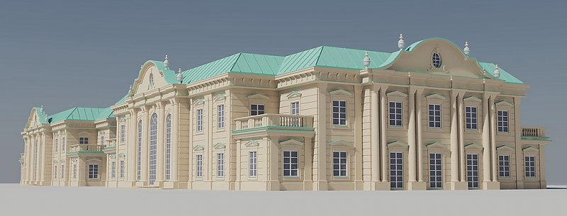

What I'm looking for, is a routine to do the following example:
I have a column on the correct x,y-position n the floor plan, but positioned somewhere in height along the z-axis. Now I want to drop it onto a balcony, the z-height of which I also do not know by heart.
What I would love to do now would be to enter "tzp" (translate along z-axis to point), click any point on the base of the column, click any point on the floor level of the balcony, and the column will drop to the correct height.
What I'm doing now is either
1) to measure the distance, copy the z-value, enter "tz" (for translate in z-direction), paste the value, and enter or
2) use point filters. Enter "t" for translate, choose base point, click "xy", choose base point again, click "z", choose aim point.
Both ways are somewhat tiresome ... does anybody want to make me happy? Of course, it would be great, if this worked along all axis, but I'm 'fit' enough to make copies and change the axis parameters myself ... :)
Find attached what I'm working at right now and thanx!

Incidentally, that's one hell of a drawing. Very nice! :D
