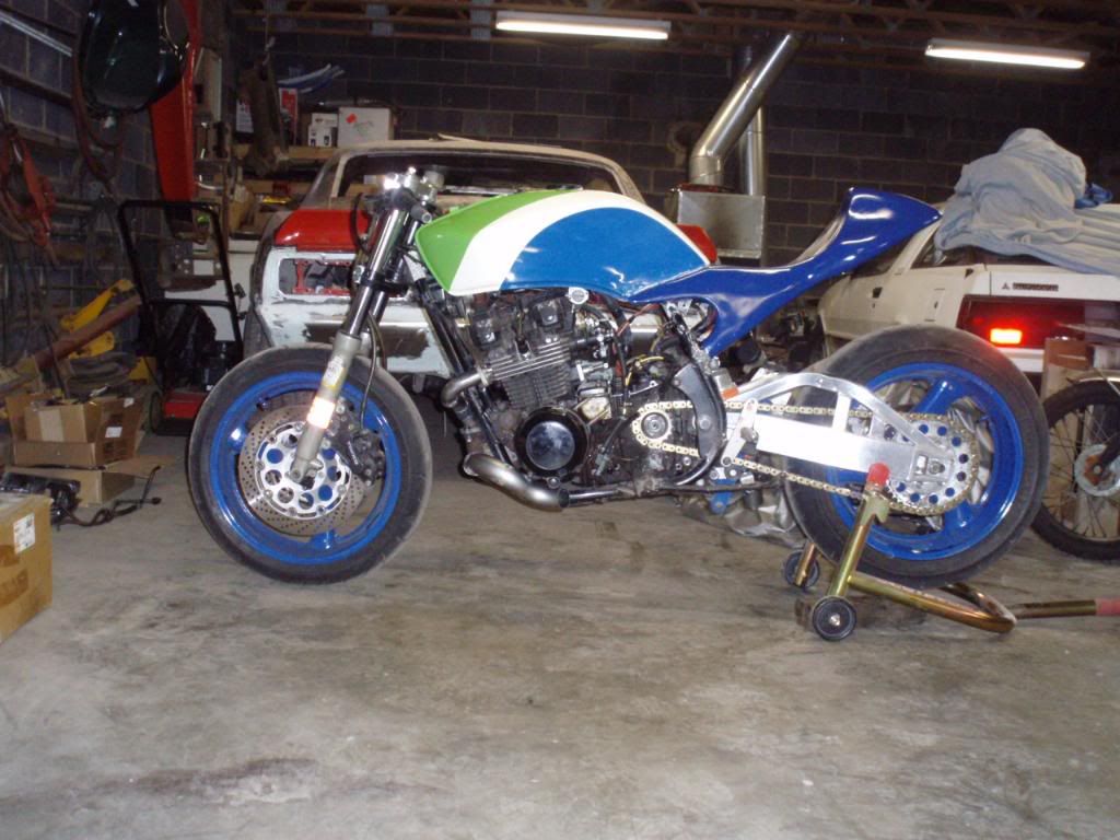

Ah a fellow biker! I can’t quite see what machine that is you’re piloting though. :D

The bike is a compilation of a few:) 83gpz 750 frame and engine, gsxr suspension and wheels, lots of custom parts and a turbo of a diesel bobcat, FI... its a work in progress.
http://i268.photobucket.com/albums/jj39/shift1313/GPz750/PB010002.jpg
what do you ride?
