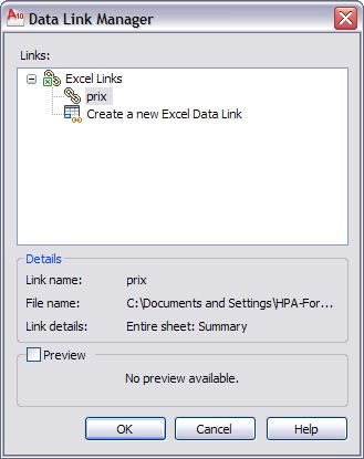

how do you remove links to other data sources usch as excel? I had copied a table from Excel and pasted into my drawing in paperspace, on several layouts. I have since deleted these on each layout however when I try to print anything, i get a pop-up message (8 times!) asking me if I want to update the link. How do I get rid of this annoyance? Thanks in advance
Try this. Set the variable DATALINKNOTIFY to 0 then test it. What happens?
Per your AutoCAD Help file he proper way to remove a datalink is...
Select the data extraction table and right-click. Click Data Links > Detach Data Link.
I tried changing datalinknotify to 0 but it didn't help. I also went to Tool/Datalinks/update data links and I am told that no data links exist. Yet when I exit the drawing and re-open it, I get the same multiple prompts to update the link. Further thoughts?
None at the moment. I've never had to remove a datalink so I would have to experiment with a drawing that has one.

I am back
I used data extraction and link data
No problem when I print.
But when you open Externals reference the link with excel it still here
Maybe that is the problem ?
Or in Data link manager, check if you have got some excel link.
(see image)
What do you think ?
