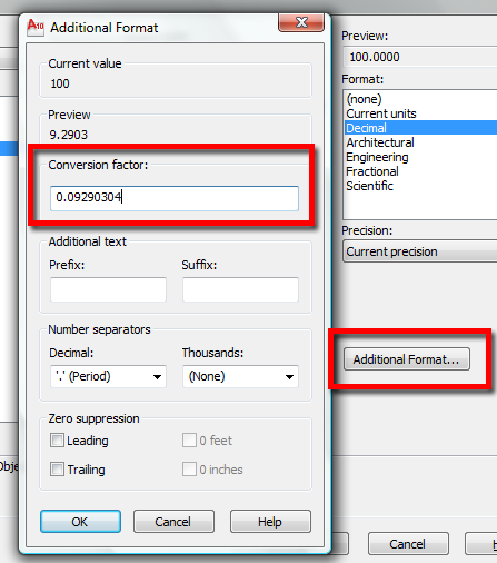

when you insert the field there should be an option of "calculation" (or similar). Select that and insert field again, placing your object then the rest of the calculation.
You should be able to enter a 'conversion factor' in the extra formatting options of the field. :thumbsup:
