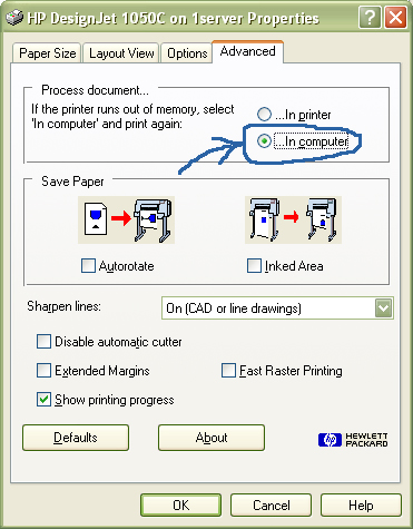

Did you tried printing it over your PC instead of printing it over the Printer memorie??

cpriedel>>>I just tried that. However, my printer is not a full size plotter. It just works with 11x17 and smaller. I tried looking under properties (both in printer control panel and within AutoCAD.) No luck:( Thanks for the idea though.
