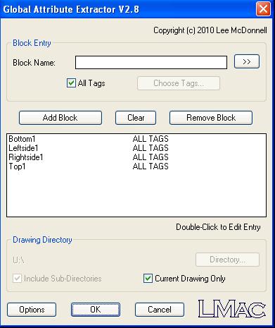

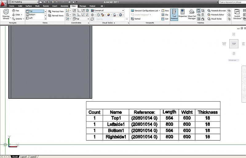

mitchellrodhous Posted June 21, 2010 Author Posted June 21, 2010 Well I am making blocks with the attechment lisp. After drawing You get an image like image 1 but than probebly in 2d view. This blocks all have theire own attributes. (Reference, Length, Width and Thickness) as you can see on the image 1, and in the drawing if you play my lisp. But than If I use command DATAEXTRACTION in cad2011 I have to select my objects than after selecting fellowing the 8 steps to complete a table. See result I want to get on image 2. Now I was thinking if theire was a lisp routine to create that kind of table, (in drawing or EXCEL Sheet) with just one single click and selecting the objects. without my 8 steps... Hope I am a bit clearer right know. See your reaction forward, Regards MR Cabinet.LSP Quote

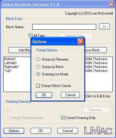

mitchellrodhous Posted June 21, 2010 Author Posted June 21, 2010 Well I played your lisp fellowing the images>> Maybe you can see by images what I am doing wrong Regards MR Quote
mitchellrodhous Posted June 21, 2010 Author Posted June 21, 2010 Aah I see you can't select the files... That doesn't work I have really to fill In the name of this block... Isn't theire a improvement needed Lee? Regards MR PS1: another improvement could be that it also exports the block name to excel? Quote
fixo Posted June 21, 2010 Posted June 21, 2010 Try to check "Group by Block" radio-button instead ~'J'~ Quote
Lee Mac Posted June 21, 2010 Posted June 21, 2010 Aah I see you can't select the files... That doesn't work I have really to fill In the name of this block... Isn't theire a improvement needed Lee?Regards MR PS1: another improvement could be that it also exports the block name to excel? I'm not sure what you are talking about? When in 'drawing list mode', the block name is not written (purely because in this mode, most users will be extracting the same title block everytime, and don't wish to see it written), however the block name will be written when using the other modes. What do you mean select the files? Quote

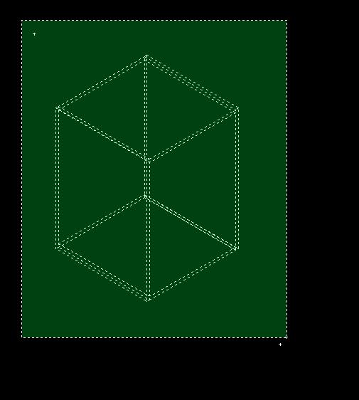

mitchellrodhous Posted June 21, 2010 Author Posted June 21, 2010 Yep you're correct It wil fill in the correct block name, but I have still need to typ the blocknames to get everything correct exported. If I have an drawing with more than 300 objects/blocks It would not be great right? So I want to select the blocks with a crossing... Regards MR Quote
Lee Mac Posted June 21, 2010 Posted June 21, 2010 Aah I see you can't select the files... That doesn't work I have really to fill In the name of this block... Isn't theire[sic] a improvement needed Lee? I'm not sure that you know how to use the program. Quote
Lee Mac Posted June 21, 2010 Posted June 21, 2010 Yep you're correct It wil fill in the correct block name, but I have still need to typ the blocknames to get everything correct exported. If I have an drawing with more than 300 objects/blocks It would not be great right? So I want to select the blocks with a crossing... Regards MR You can select the blocks. Quote

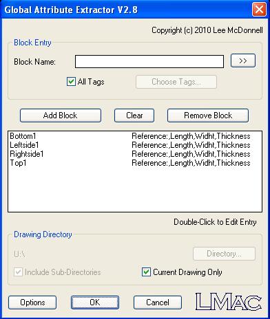

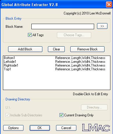

mitchellrodhous Posted June 21, 2010 Author Posted June 21, 2010 Yeah I know how it works this programm, and I can select the blocks... You're correct about taht, only If export to excel the result is like the image below: If I typ the name of the block and add it manually, not by crossing or selecting it does work. Quote
Lee Mac Posted June 21, 2010 Posted June 21, 2010 Could you upload a drawing file so that I may test it? Quote
mitchellrodhous Posted June 21, 2010 Author Posted June 21, 2010 Yeah ofcourse, just open your autocad and play my lisp routine Cabinet.lsp. cammand is kast. the lisp will ask for different dimensions. theese dimensions are in milimeters and will create the cabinet I am talking about. Than run your own programm. If you typ in your routine as blockname top1 it will add this Top1 correct! etc with the other blocks of the cabinet, Bottom1, Rightside1, Leftside1. Now try the same with a crossing over my cabinet (selecting the whole cabinet in once).. the difference between theese two you can will see on image 1 and 2 below. The 1 shows all the attributes and the other shows ALL TAGS. By crossing It wont work with me.. Regards MR Cabinet.LSP Quote
