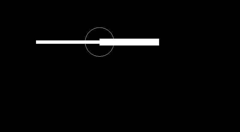

paraskia Posted June 21, 2010 Posted June 21, 2010 Hello,I'm new here so i 'd like to apologize for my English and i hope that I've made the right decision for my thread. I'm having some printing problems.In particular i would like to know how cam the ink stay in the inner side of the drawing instead of instead of being axially. thank you in advance Vivi Quote
Tiger Posted June 21, 2010 Posted June 21, 2010 Hi Vivi and welcome. I think we need an image of what you are trying to achieve. What do you mean with 'axially'? Quote
paraskia Posted June 21, 2010 Author Posted June 21, 2010 i have a drawing in a small scale, 1/50. So i have lineweight which is thin and others which are much thicker. when i print this drawing, the thicker lines aren't any longer at the same stretch. is there any adjustment that i can do? Hope i made you understand. Quote
Tiger Posted June 21, 2010 Posted June 21, 2010 Aha ok, now I see. Lineweight can be set on several different places. Do you use a CTB-file when plotting? In there you set LIneweight, and if you have something set there, it overrides the lineweights set in the actual drawings. Quote
paraskia Posted June 21, 2010 Author Posted June 21, 2010 I'm very sorry that i can't express myself well enough. My question is if it is possible to choose the side of the line in which i want the ink. I have set the lineweight but during the printing, the ink is put in left and also in the right side of the line and as a result, when i have 2lineweight, for example 0.8 and 0.4, the one next to the other, i have a small "tooth" which I don't want. Thank very much for all your effort. Quote
ReMark Posted June 21, 2010 Posted June 21, 2010 It would be nice if you posted an example. Is this what you are talking about? Quote
paraskia Posted June 21, 2010 Author Posted June 21, 2010 yes! i don't know how to post an example, I'm sorry, but this is exactly what I mean. Quote

ReMark Posted June 21, 2010 Posted June 21, 2010 The condition shown above is the result of two different polylines each assigned a different width. To eliminate the "tooth" as you call it you could assign both lines the same width, eliminate width altogether or create a transition piece of line bewteen the two that has a different starting and ending width. Quote
