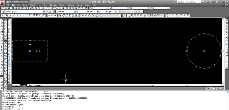

I wrote this:
(command "purge" "_all" "" "_no")
;Insert the first Block
(setq blk "circle")
(setq cord (list 50. 0. 0.))
(command "_insert" blk cord 1. 1. 0.)
;Insert the second Block
(setq blk "rectangle")
(setq cord (list 0. 0. 0.))
(command "explode" "_all")
But surprisingly the explode "all" just explode the first item!!!
by using the "explode" command on the command line you can explode the rectangle later manually!
How can I fix this problem?!
Cheers
Ali
For compatibility with old AutoCAD releases, the EXPLODE command accept only one item when used trough AutoLISP - set QAFLAGS system variable to 1 to force it to accept more than on item. Regarding "_all" option try to use SSGET statement instead.
(setvar "QAFLAGS" 1)
(command "._EXPLODE" (ssget "_X") "")
(setvar "QAFLAGS" 0)
