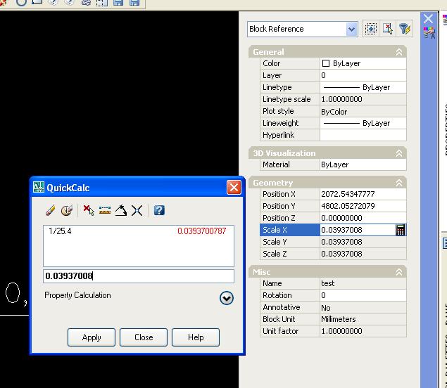

I agree with Tiger that you appear to have a nested block and following her method of creating the block should eliminate your problems.
However to close out my suggestion, I can confirm that in 2008 TICKING the "scale uniformly" (obviously changed for 2010) box does not eliminate the error introduced in the AutoCAD scale command. I may be wrong in assuming it was the Z scale but here is a 10mm cube scaled @ 25.4:1
[quote]
Command: list
Select objects: p
1 found
Select objects:
BLOCK REFERENCE Layer: "0"
Space: Model space
Handle = b8b8
Block Name: "test"
at point, X=2072.54347777 Y=4802.05272079 Z=0.00000000
X scale factor: 0.03937008
Y scale factor: 0.03937008
rotation angle: 0
Z scale factor: 0.03937008
InsUnits: Millimeters
Unit conversion: 1.00000000
Scale uniformly: Yes
Allow exploding: Yes
Distance: 0.39370079
this demonstrates there has been a rounding error somewhere as the distance should be 10 x scale, and the block is no longer dynamic. If I now select its properties and apply (via the calculator) a scale of 1/25.4 it becomes dynamic again.
