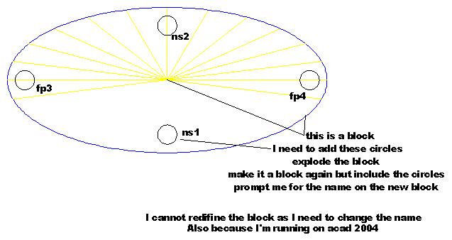

Insert block, add circle, exlode, create block
I need to insert a block
Prompt me for the block name
Prompt me for the y scale of the block
prompt me for the overall size of the block
insert the block
add the circles
explode the block
create a new block that includes the circles
please help

I don't know if it's practical to use a macro to make a block. I don't mean to hit this forum with a big ask. I can easily make this into a block.
The BIG help would be to draw the 4 circles.

The block is the circle. I insert it, scale the y (.5 in this case)
and then scale the block (5000 in this case)
Add the circles (fp 3 and 4 are the focal points of the ellipse)
and add the ns points
the line going through ns2 does not need to be trimmed.
The dia of the 4 circles are 0.04 * the overall size (200 in this case)
sdial.dwg
I'm trying to draw the 4 circles as shown in the drawing above but keep getting an error
