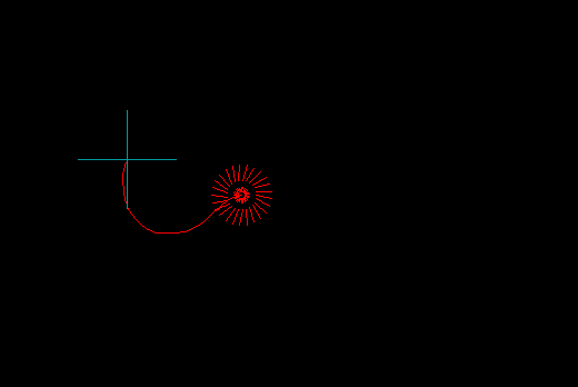

I think I've posted it before somewhere:
(defun c:bored ( / cir cnt gr lst n d )
 ;; © Lee Mac 2010
 (setq lst (list (getvar 'viewctr) (getvar 'viewctr)) cnt 0)
 (while (eq 5 (car (setq gr (grread nil 13 0))))
   (redraw)
   (setq cir nil n 0 lst (append lst (list (last lst) (cadr gr)))
         cnt (1+ cnt))
   (if (< 100 cnt) (setq lst (cddr lst)))
   (repeat 50
     (setq d (/ (distance (car lst) (last lst)) 4.))
     (repeat 4
       (setq cir (cons (polar (car lst) (* (setq n (1+ n)) (/ (* pi 2) 50)) d) cir))
       (setq d (/ d 2.))
   (grvecs (append (list (rem (/ cnt 100) 255)) lst cir))
 (redraw)
alanjt:
