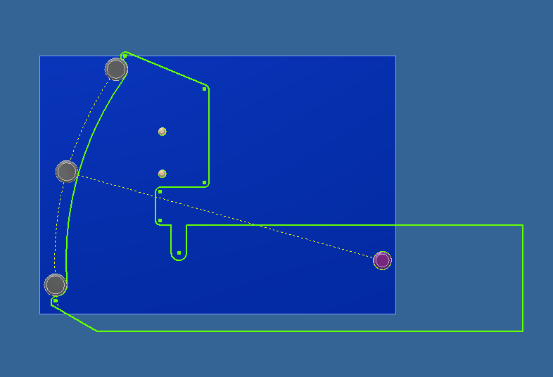

I have been designing some Gauges for part and assembly verification. I used the Face Export of the part so I could get the general outline and placement for pins and so forth. Does anybody know how to get the Sketch (Face Export) to show up in the .idw drawing, I would like to be able to show how the orientation of the part fit on the Gauge.
Here's a screen shot of one of the Gauges, I would like to show in dashed lines on the drawing what is in green.
Thanks in advance for any help

In your Drawing Browser, find the part and select GET MODEL SKETCHES
Hey thanks Mark, that was the ticket. I had tried that before without results, then I realized I needed to INCLUDE the sketch,,, worked great.
Thanks again
