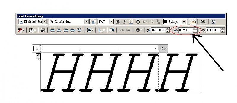

Where can I check character spacing?
Crispotts.
Crispotts,
Check the ScreenShot.
I guess the correct term is "tracking".
Let me know if that helps *_*
Hi Skybeorn.
Muchos gracias mi amigo
All sorted now.
