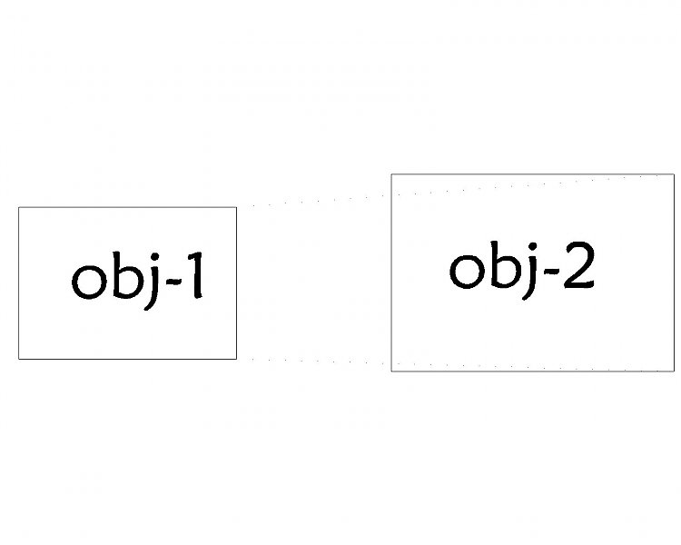

You can use the align command instead.
Command: align
Specify first source point: HERE SELECT ONE POINT OF OBJ 1
Specify first destination point: HERE SELECT CORRESPONDING POINT ON OBJ-2
Specify second source point:HERE SELECT ONE MORE POINT OF OBJ 1
Specify second destination point:HERE SELECT CORRESPONDING POINT ON OBJ-2
Specify third source point or :
Scale objects based on alignment points? [Yes/No] : y
immediately after this use the move command
"MOVE " and hit enter
then say "p" (previous)
& move the selected objects sufficient far from the other.
