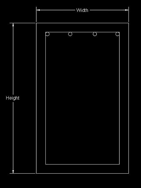

Hi
I Made this Lisp file called Beam.lsp and it is making the rectangals without being able to make circles as well ;

Any help would be highly appreciated.

okay try this:
Just realised you wanted main bars on top I put them on the bottom - but you can adjust to suit.(just beam rebar on top only - very odd!)
Your stirrup corners do not have bends so I have added them.
I have also added a variable called 'cover' which is critical when drawing rebar sections.
There are other things that could be improved but it's a start....
hth

Thank you so much for hard work on my lisp file.
The pose of my lisp will make a beam with steel bars up side and down side as well , and I did not included them, because I lost in the begining and I concentrated on the user inputs which prevented me to reach the end of it to make the low down bars functions, and that is why you said it's very odd but it is not in reality.
your lisp gave me a help but I am still working on it to get the best performance of the lisp completely.
Thank you once again for your kind help.
Yours
Tharwat
You are welcome - glad to help out.
more suggestions - since you have many input variables, it would be a good idea to create a dialogue box, rather than command line driven prompts.
- you should show ends of the stirrup in one of the upper corners.
SF :)
