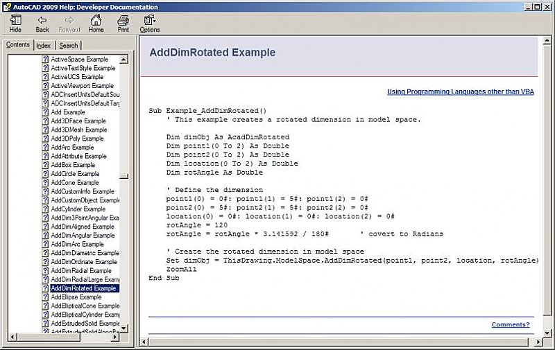

How to draw a linear dimension in Acad with VBA?
Any advice? Haven't really found any tutorials /answers on this part
A linear dimension is referred to as DimRotated in the VBA api. This is the example used in the Developer Documentation. Is that any help?
Yeah! Tried to look inside the help file, but i somehow missed the developer documentation :D.
P.S.: In this example and others, I've seen stuff like point1(0)=0#: what does # do and what does : do?
The # symbolizes a “Double” data type. It is inserted automatically by the VBAIDE. If point1(0)=0.0 is typed in, it will automatically convert to point1(0)=0#
The : allows more than one statement per line of code. so
point1(0)=0#: point1(1)=0#: point1(2)=1#
is valid.
