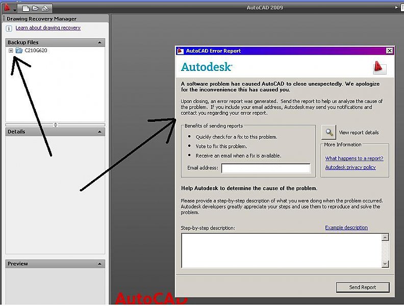

SwChilly Posted June 25, 2010 Posted June 25, 2010 I was just in a drawing and it was automatically saving (another issue is that it take 2 minutes for it to save), and it timed out on me and I got the AutoCAD Error Report screen, then it doesn't respond and shuts down. So I tried to reload the drawing but it won't even open; I keep getting the AutoCAD Error Report Screen and same thing, it shuts down. I have tried opening it through My Computer and same thing. What the heck did I do? I can load other drawings just fine. I looked for other threads like this but couldn't seem to find any info. I treid restarting my computer but that didn't seem to do anything. Quote
Cad64 Posted June 25, 2010 Posted June 25, 2010 Try opening the drawing using the RECOVER command. Quote
MSasu Posted June 25, 2010 Posted June 25, 2010 Try to open the drawing using RECOVER command. If this doesn't help, rename the BAK file with DWG extension and use it. Regards, Quote
SwChilly Posted June 25, 2010 Author Posted June 25, 2010 Try to open the drawing using RECOVER command. If this doesn't help, rename the BAK file with DWG extension and use it. Regards, I've tried with recover but it didn't work.. I didn't change the bak file... I'll let you know what happens I try to click the plus sign beside the recovery file and i get that message right away. Also, tried to type recover and same thing... I don't know what I did but AutoCAD does not like me! Quote

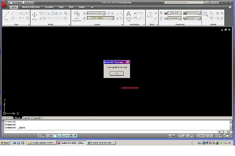

SwChilly Posted June 25, 2010 Author Posted June 25, 2010 K i managed to get the .bak changed to the .dwg... so after working on that for a while it suddenly went "Read Only", so I closed it and tried to reopen it and now I get a message saying "Drawing file is not valid".. Suggestions? Tried DRAWINGRECOVERY but there isn't anything on that list anymore. Also, with RECOVER, I still get the "Drawing not valid" message I tried looking up information but the threads don't seem like they pertain to me. I'm gonna start a new thread since this seems like a new issue.... Thanks guys! Quote

SwChilly Posted June 25, 2010 Author Posted June 25, 2010 Ok here's the scoop: I am working on a 2009 drawing that I have been working on all week. I was having issues with Autocad earlier about not being able to open the drawing but then I changed the .bak to .dwg and life is good. Suddenly, the drawing goes to "Read-Only" and so I close out of it and go back in it and I get a "Drawing File is not Valid" message. PANIC! I checked that it is in fact a .dwg and not any other extension. I tried RECOVER but it says "Unable to recover file" and I tried DRAWINGRECOVERY but there isn't anything listed there. Any suggestions? Quote
MSasu Posted June 25, 2010 Posted June 25, 2010 You don't need to start a new thread on this issue. If your drawing still has errors try to run an AUDIT on the recovered BAK file. Regards, Quote
Cad64 Posted June 25, 2010 Posted June 25, 2010 Starting a new thread just throws out all the advice you were already given and sets you back to square one. So in order to keep you from getting the same advice about running Recover, Audit, rename your .bak file, etc., I have merged your two threads. Quote
