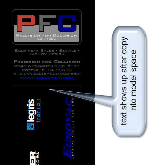

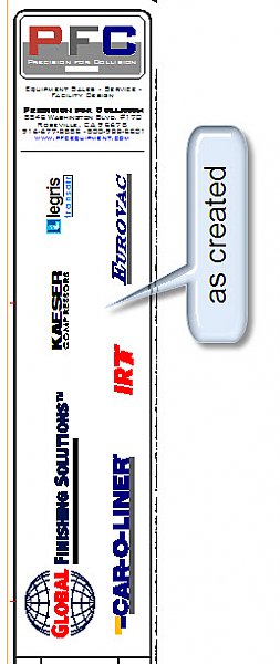

Recently updated title block info and company logo. Did mods on master base sheet (paper space),then made a block of the whole thing.
When I insert the block to update other title sheets, it doesn't all show up. If I copy it from the paper space to model space, it does all show up in the same dwg........what the flip am I missing?

Don't know why, but the problem was test size! When making the logos I used scaling to get them the correct size (scaled text as well). For some reason after all was said and done, the text size was "0" in the text editor for the items that were not showing up when being inserted, but yet I could see them in the master block. Redid the text with a "real size" and ta-da.....they show up now!
Though it makes no sense to me, thought I'd share the resolve so someone else who encounters similar doesn't experience the anguish I did!!!!!!
