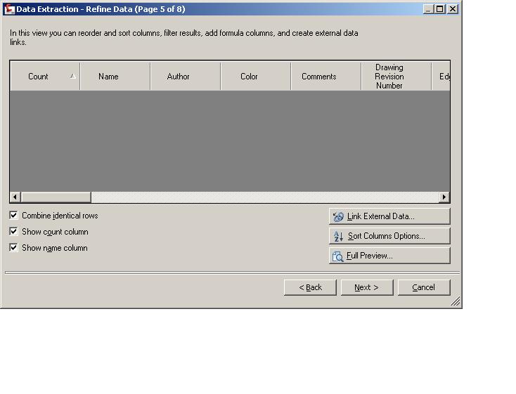

Is it possible to data extract X,Y postions from a load of text elements. I have a drawing with hundreds of text which represents housing plots on a site and I need the co-ordinates. Data Extraction seems to want to do it but when I get to the end I get nothing.

Hmmm.
EATTEXT seems to work no problem. I wonder what the difference is?

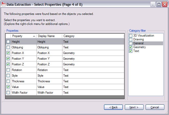

Hi happyunited,
Verify in the stage 4 if you shall not have shot geometry and text
see image
Bye
Pascal

According to my help EATTEXT starts the Data Extraction so no clue :?
