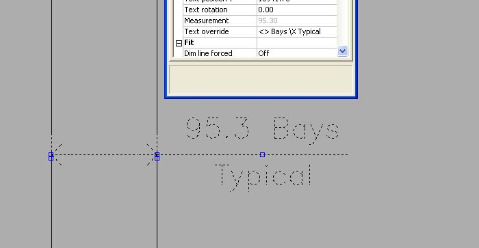

When editing a dimension with text, I would like to make the text appear both under and above the extension line.
I know how to stack the text by using \pENTER TEXT.
But this sits the txt above the extension line.
Iwould like it to be split between as shown on the attached image.
The maximum text will be over the 2 lines as shown.
Thanks again.

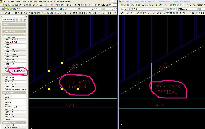

I do used that but sometime the text goes the same as the text sit above the ext. lines (\x TPY) .any other solutions that can be fix?
I think you need to use a capital X ... e.g. \XTYP
Yes, It has to be a capital X e.g \Xtext.
