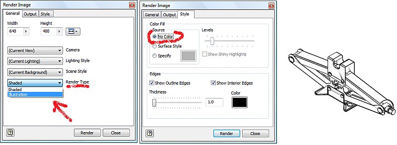

I know what the illustrations should look like I just do not know how to get Inventor to produce them. I don't seem to be able to get around not displaying hidden edges and/or shading. How do I get to Illustration rendering you mention above in Inventor 2009?
Set your screen background to white -
