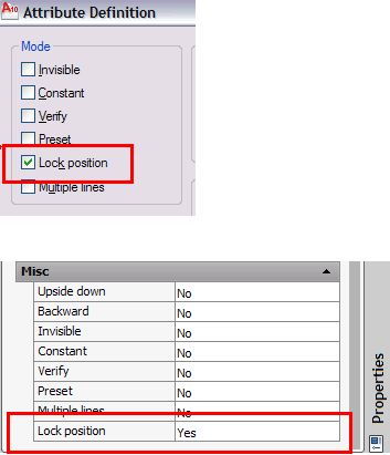

If you want just move your attribute position 2 solutions
1- When you create your attribute, your can uncheck Lock position
2- it is already create open block editor/select your attribute in properties palette/Misc/Lock position -->no
Dont forget ATTSYNC to synchronize your attribute !
See image
Bye
Pascal
