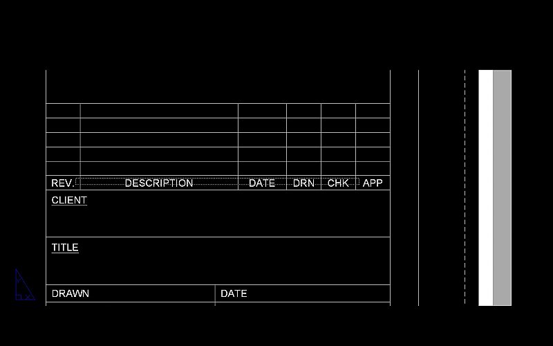

i have a table on loads of drawings which all require a new row with the same contents (it's a revision box with the date, issue no. etc)
when it was simple lines and text i could just copy with base point and drop it into each one - but if i copy a row from the table the whole table is copied.
is there a way to just copy one row from a table and add it onto the last line of tables in other drawings?

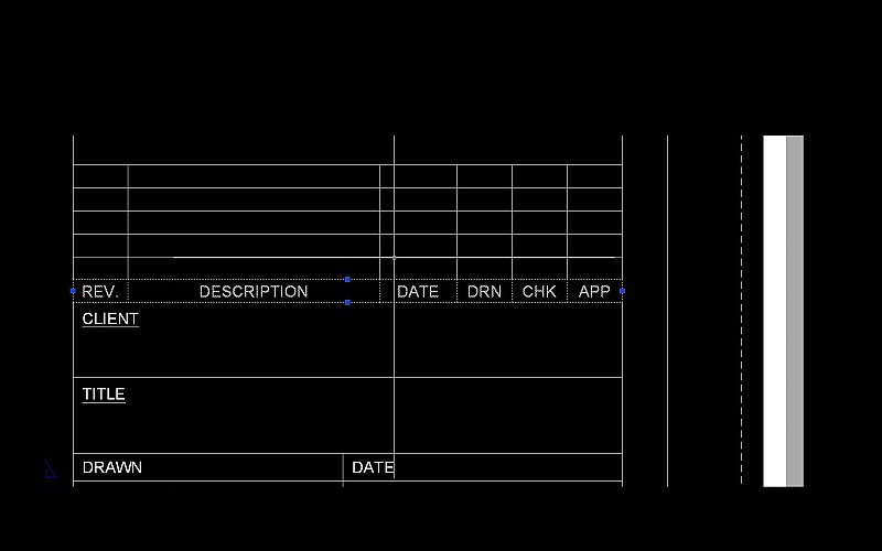

Select the row as shown below. Keep the left mouse button pressed as you draw the selection window:
Once selected it will look like this:

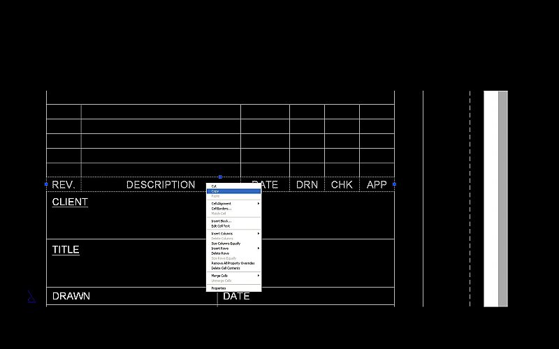

Right-click to copy:

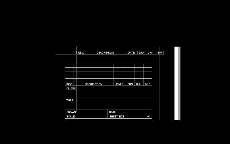

Hit escape, as to successfully paste the copied row, you must not have anything selected. Right-click and paste the row into your drawing:
Hope this helps.
thanks bonehead, but i wanted a way that made it part of the destination table. appreciate the help though!
