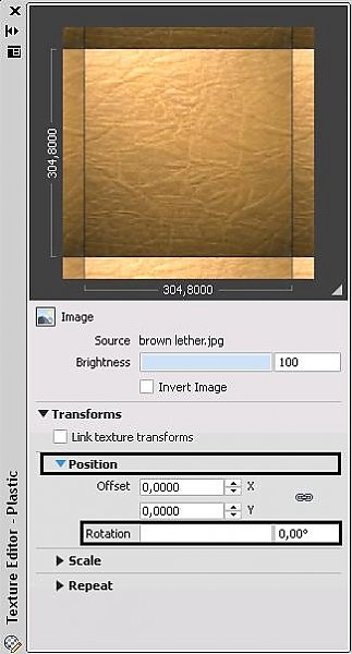

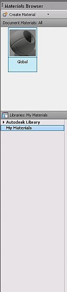

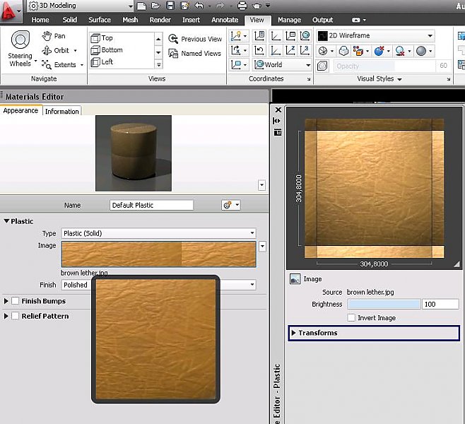

Yep, open material library, "MAT" double click on the material you wanted to rotate (notice, I believe you only can rotate materials with placed textures (images) from your texturelibrary)
see images bellow.. Is it what you were searching for?
Regards MR

Hi,
In acad2011 you can map your materials to the objects, in the render ribbon, under materials browser there is the option 'Material mapping' Use this to set your mapping!
