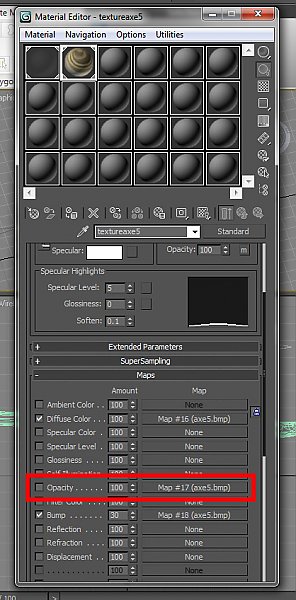

I installed Autodesk 3DS 2009 today, a clean instalation, and with MQO plug-in I import some objects, but at the time of rendering, the objects are semitransparent, as you can see in the screenshot.
Anyone know why? :huh: Thx in advanced

Do you have Opacity applied to your materials?
Can you post some screenshots of your material settings and render settings?

Yes, i'm not an expert on this, but I can see in Material Editor > Opacity 100% as you can see in the screenshot. Anyway, now the file is a zip, with the 09 and 10 plug in too.

I just checked, and there is a map in the Opacity slot. Uncheck "Opacity" and render again.
Listo! Thank you so much. I don't know how this happened, but thank you. =)
