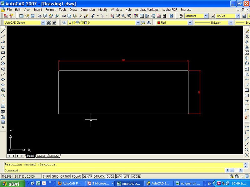

I use two identical AutoCad 2007 one at home the other at office. they have different setting. At home it is always 2D with no problem. The one at office opens at 3D.
Attached is a snapshot of ACAD from home. As you can see I can't find a gear on bottom right side of screen.
Click the little down arrow next to the lock. This will open a pop up menu that will allow you to enable the display of the workspaces gear icon.
In the attached image, Which of the ticked items shows the workspace?
I think icons inside the little down arrow controls the toggle buttons on the bottom of the page and (snap, grid, ortho, polar, otrack, ducs, dy, lwt, model) it has one named: paper/model. DO you mean this icon should be clicked? clicking this toggle button shows the .MSPACE and .PSPACE command alternatively in command line.
It's been a long time since I've used 2007. Looks like the Workspace option is not in there.
Well, you have two options then. You can either type WORKSPACE at the command line and choose SETTINGS from the list of options. Or, use your Workspaces toolbar. I can see in your screenshot that you already have it open and it's set to Autocad Classic.
