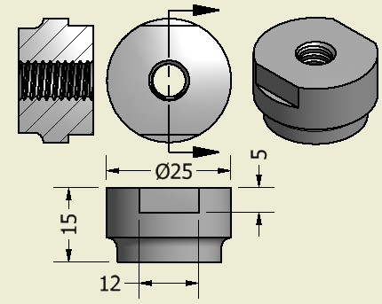

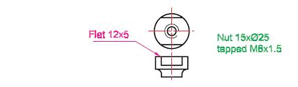

i m having problem with making 3d screw " Nut 15 x Dia 25 , tapped M8 x 1.5 " i can't understand what it says... :(
Nut 15? Dia 25 ?
tapped M8 x 1.5 ?
plz any one help me to solve this mystery ??
i need step by step help for making 3d nuts and bolts .
The absolute number one most important thing to do before starting any 3D project is to do your research. Find reference images, gather technical data and understand fully what it is you are going to create.
Do you know anything about metric nuts and bolts? Have you done any research on your own?
M8 x 1.5 is a metric thread designation. The M8 refers to the major diameter of the thread, (8mm), and 1.5 is the thread pitch, (distance between each thread). This means there is a thread every 1.5mm.
I have no idea what's going on with that nut though? The drawing makes no sense. The plan view and the section view look completely different. Almost as if they are two different parts?

yeah those r two different parts.
Nut looks like one part to me - missing dimensions tho?
And 1.5 is not a standard pitch for an M8.
Yeah, I'm looking at it with a fresh set of eyes now. It wasn't making sense at 6:30 this morning. :bloodshot:
Yes, I know. I didn't say it was a standard pitch for M8. I said the 1.5 represents the thread pitch, regardless of whether it's standard or not. Maybe the OP is making a non-standard M8 thread?
Or this. (I would always dimension across flats - not width of a flat on a cylnder. Go out to the shop floor and try to hold dimension on flat width. Doesn't relate to wrench size anyhow. 12mm might be small for this nut, in either case the dimensions don't match the image.)

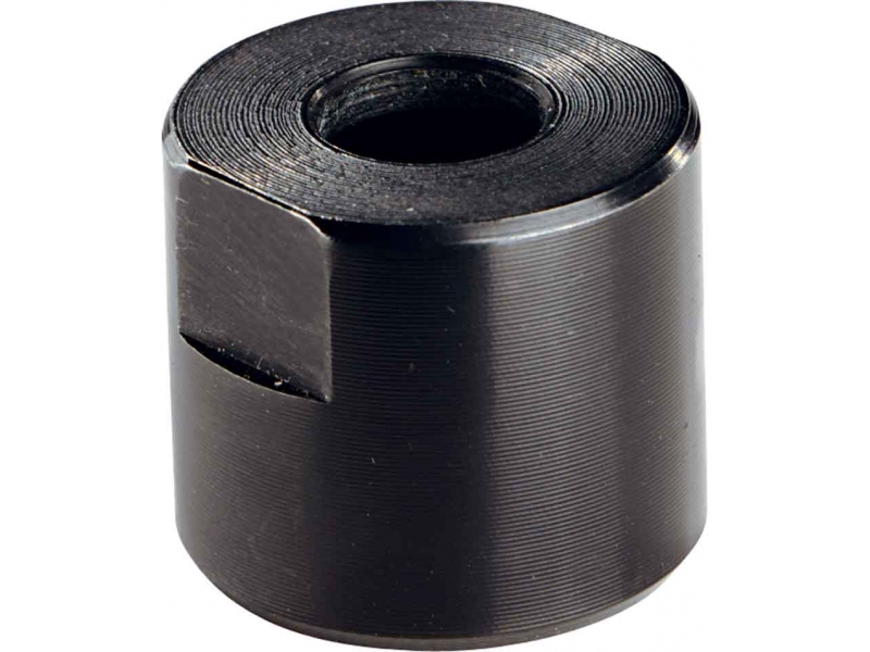

thanks sir "JD mather" and "CAD 64"
u have solved my problem.
i was also in trouble , whether those r two different parts or one.
but this picture clears it .
thanks a lot.:)

I just found it, Its look like a part of collet chuck
