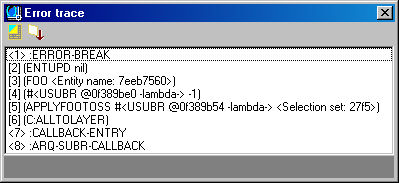

Hmmmm. I get
; error: bad argument type: lselsetp nil
Hmmmm. I get
[ATTACH]21511[/ATTACH]

Hmmmm. I get
Sorry Rk, I can't seem to get it to fail - even with nothing in the drawing :(
Try it with a VIEWPORT entity in the drawing.
Aha! Many thanks - I shall look into that :oops:
Of course, I overlooked the fact that you cannot entmod a Viewport... - quick workaround posted in previous code post.
