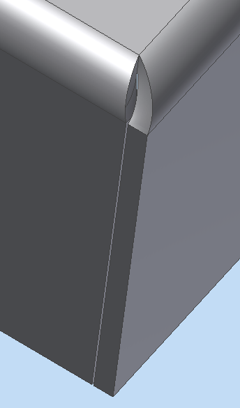

hi JD,i am now using autodesk inventor 2008 for the sheet metal...but i am stuck on how tojoin the conners after attaching the flange...require ur help...i am attaching the pic of the file.

I assume something like this is what you are after.
ya thats what i was looking for...thanks alot for solving it.

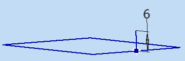

Create Sketch1 as shown. Notice the position of the Origin Center Point.
Exit Sketch1 and start Sketch2 on perpendicular Origin workplane.
Create the vertical line at the Origin Center Point as shown (note that your sketches change color when fully constrained).
(I turned off visibility of dimensions in Sketch 1 for clarity.)

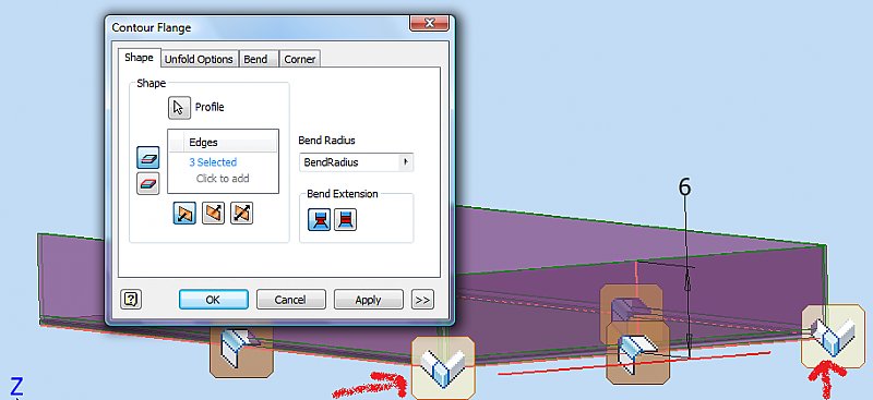

Now go ahead and use the Face tool.
Then select the Contoured Flange tool and select the vertical line from Sketch2.
Then click all three of the 3 bottom edges of the Face, starting with the edge that actually attaches to the 6mm line.
Your screen will look a bit different than mine - if you were using a later release of inventor, not from the image that you could take care closing the corners at this time.

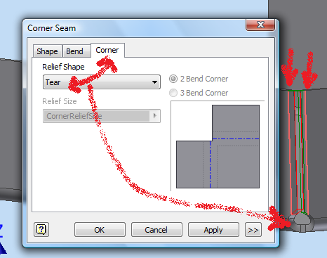

Because you have an earlier version of Inventor you will have to edit the Corner Seams as separate steps.
Start the command and click the two outer edges.
Set the desired gap (keep in mind that we cannot manufacture perfect parts - there will be a plus/minus tolerance associated with cutting the flat pattern).
Set the corner style (your dialog box might look slightly different than mine.
Experiment with every selection order and setting in this command until you understand everything it does.

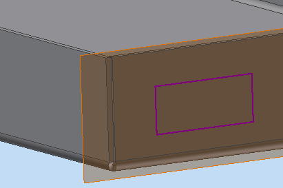

I just realized that earlier I gave you some bad information.
You USUALLY should create any sketch you can on an origin workplane rather than on a part face.
Sheet metal parts are one time when you don't try to always adhere to that general rule.
For example - if you wanted a cut to wrap around a bend you need to create the sketch on the part face.
Since in this part your cuts do not wrap around the bend I would use the workplane. Be sure to dimension size and location of cuts in your sketch.
(you don't need to turn the workplane on to use it - you can select from browser when starting a new sketch, I simply turned it on for clarity. The reason you try to use work planes when possible is that when editing features you could cause a dependent sketch to go "sick". This can be avoided by using the origin geometry.)
