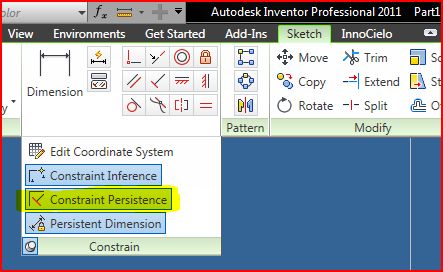

Normally, when creating a rectangle, each corner will stay at a right angle :). However, just this past week, when I have placed a rectangle, NO such constraints come in:(.
In other words, I place a rectangle, and I am able to grab a corner and drag it to any location, causing the entire shape to change. The only way I have been able to make use of a rectangle is to manually make the edges perpindicular to each other.
Have I inadvertently switched a setting? I have no idea how this happened :?.
Make sure you have Constraint Persistence selected. Including a pic to show.
ah ha! thanks so much. it looks like my "constraint persistence" button isnt in a drop down list as it is in your 2011 inventor. I am using 2010. I must have hit that thing accidentally.
Sorry, didn't notice that you were using 2010. I will catch that one next time.
thats fine. you gave me the help i needed :D
got a minor problem here too. previously, i can easily draw an arc while on a line command, but now its not working anymore. is there a setting for this as well?
Same setting indicated above. Also check your Constraint Properties (RMB) to see that you didn't turn off automatic coincident constraints.
ic, thanks. it was the constraint options indeed...

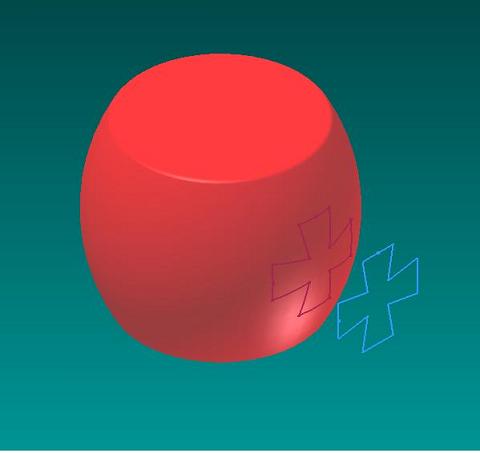

hey guys,
i have a 2d profile which i projected to a curved face of a solid. i'd like to ask you if its possible to extrude that projected curved 3d profile that is created using 3D sketch/project to surface/wrap to surface... if not, what is the right approach in order to extrude such projected sketch? thanks
Emboss or Split Thicken
