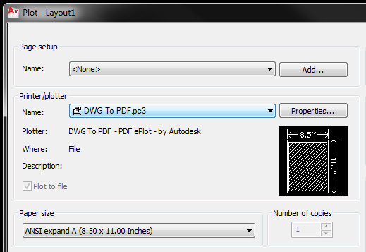

Cad64 Posted July 7, 2010 Posted July 7, 2010 Please don't post multiple threads asking the same question. I have merged your two threads. Just open your plot dialog and choose the pdf writer that you already have installed. Or use the built-in Autocad DWG to PDF plotter. Quote
dbroada Posted July 7, 2010 Posted July 7, 2010 I use the AutoCAD PDF printer. Just PLOT your drawing and select either the DWG>PDF or CutePDF printer and you will get a PDF file. Quote

Cad64 Posted July 7, 2010 Posted July 7, 2010 i don't have the pdf printer installed... where could i get it Of course you do. The Autocad "DWG to PDF" print option is one of the standard options available in the plot dialog. If you want CutePDF, just Google it, download and install. It's free. Quote
