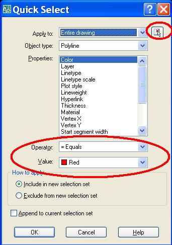

Is it possible to select objects by color?
I want to copy some objects which are red. On the background there is a hatch. I don't want to select the hatch.
What is the best way for selection and copy?
hello thank you for this.. but I tried it... it didn't work... =D how will it work?
If the entities are actually 'Red' (not Bylayer) it works.
