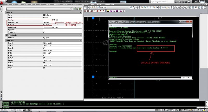

cedwards Posted July 8, 2010 Posted July 8, 2010 Hello everyone, I have a lisp request that would really help me! I need to convert the celtscale for all(for sure lines & plines) objects to celtscale/ltscale. any help would be greatly appreciated. Quote

cedwards Posted July 8, 2010 Author Posted July 8, 2010 Sorry if I didn't explain myself very well. I wanting to select all the objects in a drawing(if not all then for sure lines and plines) and change the celtscale for each object to the current celtscale divided by the current ltscale. For example: I selected a line: it's celtscale is 4 drawing ltscale is 16 I would the to change the lines celtscale to .25 (4/16) and leave the lt scale the same. Quote
Lee Mac Posted July 8, 2010 Posted July 8, 2010 Objects don't have a celtscale, rather a linetype scale that is calculated by the current ltscale and celtscale sys vars. Quote
cedwards Posted July 8, 2010 Author Posted July 8, 2010 CELTSCALE – Current Element LineType Scale – Sets the current object linetype scaling factor. You can force an individual elements LTSCALE with this setting. The Global Scale Factor value controls the LTSCALE system variable, which changes the linetype scale globally for both new and existing objects. The Current Object Scale value controls the CELTSCALE system variable, which sets the linetype scale for new objects. The CELTSCALE value is multiplied by the LTSCALE value to get the displayed linetype scale. You can easily change linetype scales in your drawing either individually or globally. The objects Linetype scale is what I'm needing to change see attach picture. Quote
Lee Mac Posted July 8, 2010 Posted July 8, 2010 I would guess you mean this? (defun c:ce/lt ( / ss ) ;; © Lee Mac 2010 (if (setq ss (ssget "_X")) ( (lambda ( i / e ) (while (setq e (ssname ss (setq i (1+ i)))) (LM:Update (LM:SubstDXF 48 (/ (cdr (assoc 48 (entget e))) (getvar 'ltscale)) (entget e) ) ) ) ) -1 ) ) (princ) ) (defun LM:SubstDXF ( code value elist ) (entmod (subst (cons code value) (assoc code elist) elist ) ) ) (defun LM:Update ( elist ) (entupd (cdr (assoc -1 elist)) ) ) Quote

Lee Mac Posted July 9, 2010 Posted July 9, 2010 (defun c:ce/lt ( / ss ) ;; © Lee Mac 2010 (if (setq ss (ssget "_X")) ( (lambda ( i / e ) (while (setq e (ssname ss (setq i (1+ i)))) (LM:Update (LM:SubstDXF 48 (/ (cond ( (cdr (assoc 48 (entget e))) ) ( 1.0 )) (getvar 'ltscale) ) (entget e) ) ) ) ) -1 ) ) (princ) ) (defun LM:SubstDXF ( code value elist ) (entmod (subst (cons code value) (assoc code elist) elist ) ) ) (defun LM:Update ( elist ) (entupd (cdr (assoc -1 elist)) ) ) Quote
cedwards Posted July 9, 2010 Author Posted July 9, 2010 That did the trick....Thank you very very much!!!! Quote
