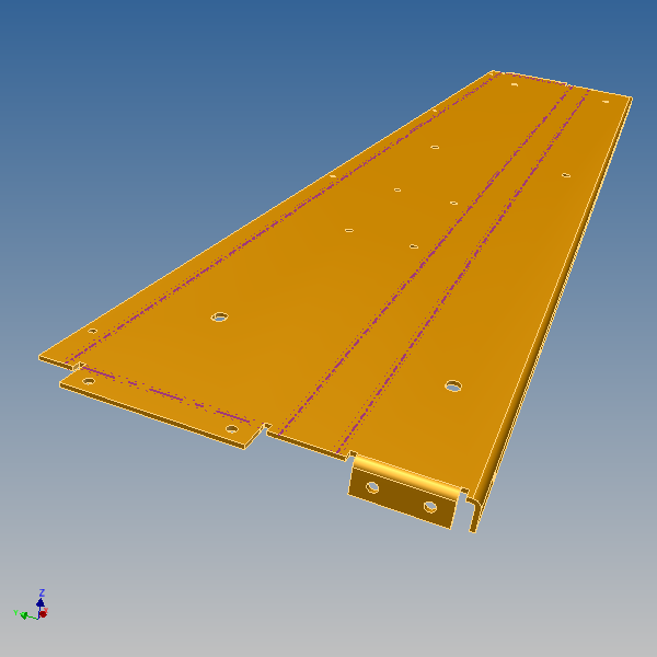

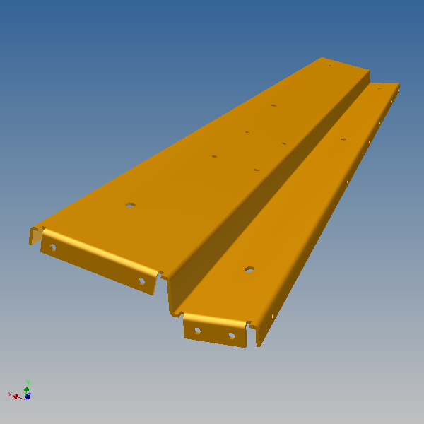

Hi Guys,
I revisited one of I-Deas IGES parts to see if I could make a translation into Inventor. Unfortunately I was not entirely successful.
Picture 1 shows the part I brought in using the options I mentioned above. I then stitched the composite surfaces together to form a solid. Turned it into a sheet metal part, setting the thickness parameter to 1.5mm, and made a flat pattern (picture 2).
You can see that Inventor has not recognised every bend.
Has JD any thoughts as to why this might be so?

I would have to see the actual part - my guess is that there is an area that is not constant thickness (no matter how small) or not planar, cylindrical or conic (Inventor can unfold native sheet metal loft, but not imported geometry that is not planar, cylindrical or conic).
There are Inventor add-ins that can, but from the picture it looks like that part should be easy to fix (or simply remodel as native).
