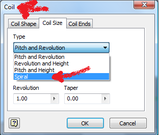

Are you looking for the Spiral option in the Coil feature?

I am trying to draw a constant force coil spring in Inventor 2013 where I can have a threaded tube move up and down and the spring will lengthen/shorten accordingly. I cannot figure out how to make the coil, or how it would work to make it coil/uncoil at the correct spiral and forces where the center diameter stays the same. Basically the same idea as a tape measure. Anyone know how to get this started? The coil feature in Inventor 2013 appears to be more for truck shock type than constant force springs.

It is not clear from the image if you used Coil to wrap the shaft or simply used a circle.
In any case you will need to create a Parameter that controls the planar portion and the round portion. So as one decreases the other increases by the appropriate amount.
Then in Studio you will Animate Parameter. This is challenging for beginners. If you have trouble figuring it out - it will be necessary to attach the assembly here.
