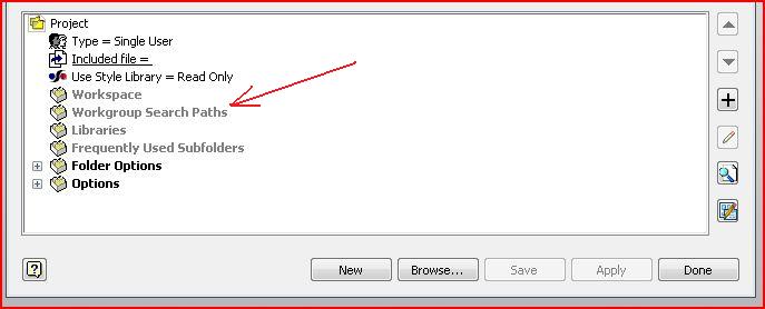

Enfiel3D Posted July 13, 2010 Posted July 13, 2010 You may setup search folders for each project, effectively instructing Inventor to look in other project folders for missing parts. I use this widely, and it works great. Quote
gargoyle27 Posted July 15, 2010 Author Posted July 15, 2010 You may setup search folders for each project, effectively instructing Inventor to look in other project folders for missing parts. I use this widely, and it works great. that might be exactly what i'm looking for, how do i do that? Quote
alanjt Posted July 15, 2010 Posted July 15, 2010 ROFL I almost spit coke all over my monitor when I saw your new avatar, Steve. Quote
Enfiel3D Posted July 16, 2010 Posted July 16, 2010 that might be exactly what i'm looking for, how do i do that? Have a look at the line marked on the screenshot, it is there. You may add extra paths where Inventor will look if needed parts are not in the active project. I advice you to thoroughly researd the concept of projects in Inventor. Do your reading and believe me - it will pay off. Quote

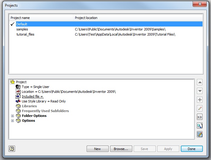

gargoyle27 Posted July 16, 2010 Author Posted July 16, 2010 Have a look at the line marked on the screenshot, it is there.You may add extra paths where Inventor will look if needed parts are not in the active project. I advice you to thoroughly researd the concept of projects in Inventor. Do your reading and believe me - it will pay off. yeah, i probably should, to be honest part of the reason i wasn't using them is because i forgot about them, and it rarely comes up that i realize i should be using them oh, and i don't have that option in projects Quote
Enfiel3D Posted July 19, 2010 Posted July 19, 2010 Don't have that option? Strange. Can you attach a screenshot? Quote
gargoyle27 Posted July 20, 2010 Author Posted July 20, 2010 here's a picture of my projects window Quote
Enfiel3D Posted July 20, 2010 Posted July 20, 2010 Oops, I just realised that you are using Inventor 2009. In this case, I believe, the path should be added to the Libraries section. Try it and get back to us with the results. Quote
gargoyle27 Posted July 20, 2010 Author Posted July 20, 2010 hmmm, seems to be working fine, i'll let you know if i have any more problems Quote
