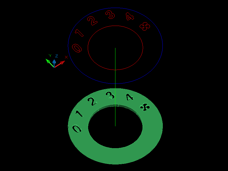

I'm trying to ectrude an object at an angle ill upload the dxf
Basically i want to extrude at an angle but i dont know the angle but know the distance it needs to cover i've drawn it in front on and side on view to try and explain what i need doing
Thanks in advance,
Wes.
help.dxf
The numbers need to be cut out of the final shape.
What i was struggling with was getting them on the correct plane/angle
and also the centre needs cutting through
Thanks,
Wes.
why don't you just extrude the numbers up and then subtract them from the final shape?
I agree... Loft, Press pull and subtract.
