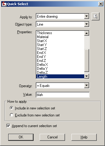

Follow alanjt's advice in post #3. It does work. I know because I tested it moments ago.
Command: QSELECT
Object type: Line
Properties: Length
Operator: =Equals
Value: type in the length of line you are looking for then press the OK button.

Presumably you didn't enter blah in the last field? Instead inserting the actual length of line for which you wanted to filter? :|
Did you specify the selection set of entities to be filtered, by clicking on he button in the upper right corner?
