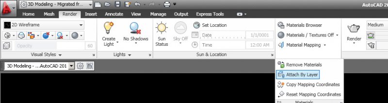

i see there 3 option to upload MATERIALS but i dont know where to apply??
Materials can be applied to objects individually or assigned to a layer.
yea thanks for your reply!
sir how can it be assigned to layer? would you mind if i ask.
This can be accomplished using the Attach By Layer tool in the Render tab's expanded Materials panel.
where is that Render's tab sir? is the material panel using the rmat command?
if you use the MATERIALATTACH command you can attach materials to certain layers
As ReMark said, Render tab's expanded Materials panel > Attach By Layer
Thank you so much sir ReMark, sir dTaylor & sir Cad64. I appreciate for sharing to me your ideas..
A picture is worth a thousand words.
