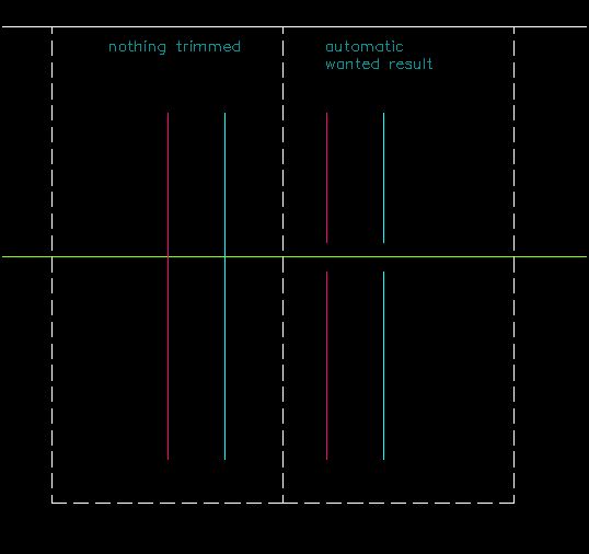

Our company works with autocad to draw P&ID's. We got a small thing that may saves us a lot of time. Our drawing contains a lot of crossing lines wich need to be trimmed. Is there a way in autocad to automatic hide a part of a (horizontal or vertical) line when it is crossed by another line. It would be perfect if the line is still one single line.
See attachment for example:Capture.JPG
It sounds more like you want to "mask" a portion of the line. Is that correct?
Uhm... sort of wipeout idea, yes....
AutoCAD electrical can do this this and I therefore assume AutoCAD P&ID can too (if you have deep pockets). However electrical leaves the lines as individual elements that remain "joined" through its internal database. They don't automatically repair themselves if you remove the "cutting" line. At least I don't think so, must give it a try. I think I would go down the wipeout route if it were me :)
We use are own created autoCAD P&ID ;) But it's just a basic autocad.
Can you create a linetype in autocad with a wipeout along the side of the line? Is that an idea? Only one problem: it probably wil a completly blank cross...
Why does the line have to remain one continuous line?
Perhaps a lisp routine could be developed that would place a pre-defined (polyline) wipeout frame on either side of a line at all designated locations. It may also have to include the option of rotating the frames depending on whether it is being used horizontally or vertically.
I think it would be more easy to edit.
Like when there is no crossing line anymore, it changes instantly back to a normal line with no extra command for healing/joining your 2 lines. It's also more easy when you move or stretch.
OK. Then I think I've given you your answer.
