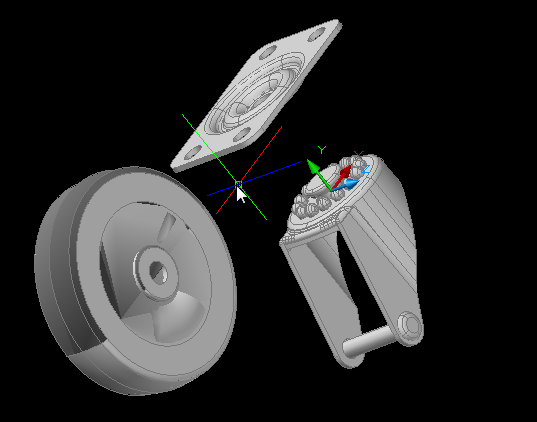

Abbyjay Posted July 22, 2010 Posted July 22, 2010 Hi Guys, I'm blocked with a time wasting issue . I need to get a 3D part from the net to avoid wasting time drawing it, I found the perfect part on 3D Content Centeral, I know I recieve it in .sat file and open it on my inventor, but the problem is, I see all the components that form my assembly, but on my work screen there is no assembly, I can open each part and see it, but in my assembly it is a blank screen (no visible part or assembly). Any ideas anyone Thnaks Have a good day Abby Quote

JD Mather Posted July 22, 2010 Posted July 22, 2010 Sounds like you have surface bodies as parts - you are going to need to learn the Construction Environment to convert them to solid bodies. Can you zip and attach one of the ipt files here? If you wan't to figure it out yourself read (watch) http://au.autodesk.com/?nd=class&session_id=3056 Not sure what kenzac was referring to - as I read your problem description -you have assembly with parts listed in browser but nothing visible in graphics window -if you open one of the parts you can see it in the graphics window (but my guess it is a yellow or orange transparent surface body) Quote
Abbyjay Posted July 22, 2010 Author Posted July 22, 2010 JD Mather; yes you are right -you have assembly with parts listed in browser but nothing visible in graphics window -if you open one of the parts you can see it in the graphics window (but my guess it is a yellow or orange transparent surface body) But I do not see the yellow/orange transparent...It is a full solid as featured part. As if something is desactivated in the assembly that makes everything invisible (they are not hidden, locked, or disabled etc...) I attached the whole file. Thanks for your help Cast wheel.zip Quote

Abbyjay Posted July 22, 2010 Author Posted July 22, 2010 JD Mather I really appriciate your time to help me out. At the open option I set my file format to .sat file so it appears in my open option, and when it loads well I see nothing except the parts that combine my assembly. I attached a .ipt see below. Abby Cast wheel.zip Quote

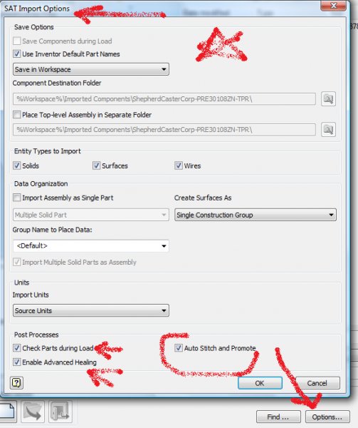

JD Mather Posted July 22, 2010 Posted July 22, 2010 At the open option I set my file format to .sat file so it appears in my open option, ... Uhmm, I think you missed what I was referring to on Options (see attached). Do you have set for Advanced Healing, Stitch and Promote, and Check Parts (quality) on Import Options? Quote

kencaz Posted July 22, 2010 Posted July 22, 2010 The wheel is damaged... easy to revolve in Inventor and re-assemble... KC Quote

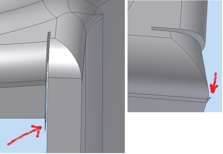

JD Mather Posted July 22, 2010 Posted July 22, 2010 (edited) Well this is interesting. The file was created in SolidWorks, but I can't get SWx 2009 to open the file. I can get it open in Pro/E Wildfire 4, but a different part shows an anomaly (the wheel is fine). Did a bit more checking and found poorly trimmed surfaces on the bracket that don't pass quality check as well. Doesn't look like the SWx operator was very experienced. Edited July 23, 2010 by JD Mather Quote
