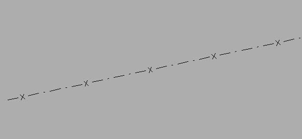

i work for a survey company, we need to make a line type for a fence line... i was trying to use the existing fence with the circ1 on it.. but not quite working... how can i customize to look like this...( ---x---x---x---x-- )
Here is one that I wrote earlier, but you can alter it to suit.
*BARBEDWIRE1,Fenceline -X-X-X
A,.5,-.25,["X",STANDARD,S=.24,R=0,X=-0.12,Y=-.12],-.25,.5,-.25,.05,-.25,.5,-.25,.05,-.25

i did modify the line to be a continuous line between each "x"
