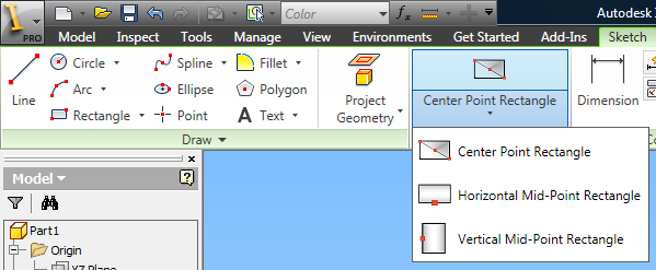

JD Mather Posted July 25, 2010 Posted July 25, 2010 Here are some of mine: 2D Sketching: 1) "Haystacking" of sketch geometry I would vote against - there is too much sloppy modeling already. Just my personal opinion. 3) Ability to draw a rectangle/square about a centre point. CPR add-in 2) Ability to create more than one part at once. To save as individuals or join together to form one solid. The current method of doing this within assembly modelling is way too messy and time consuming. Uhmmm, multibody solids and boolean combine added two years ago (r2010). P.S. does anyone know if Autodesk watches this web site? Autodesk had an Inventor user forum and and Inventor user Wish List site? Quote
