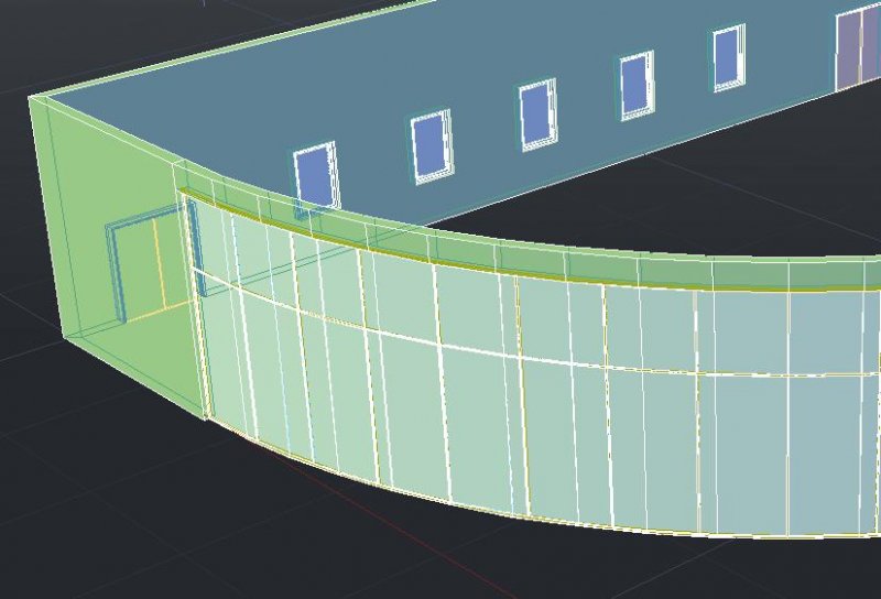

3. In the model I'm working on I have a curved curtain wall. When exporting to a regular AutoCAD model it seems to get divided into a number of facets which aren't related to the individual frames. Is there a way to keep each pane whole within the frames? I think I've read somewhere about curved vs. faceted curtain walls, but it didn't explain in depth. Here's an image of the model:

But the curved window is still showing up as faceted (as does the wall above it).

Still looking for a solution to no.3 question above. The only thing I can think of so far is to create the curtain wall without any glass, or delete it afterwards, then create the glass sperately. Althought that would still leave a segmented frame and wall above, which is less prefereable than a curved one, although I think it might do the job.

for number three, use the command AECFACETDEV. and set that to say .00000045, that should add TONS of facets to make it appear curved. You can link your model from Autocad Architecture to MAX, so you do not have to export your model to autoCAD.
oh really? I will try that. I just thought that Max wouldn't recognise the AEC objects, but I will give it a go, and if not your other solution sounds good. Thanks!
It should, I have not messed with Max much, but what I did do worked great.
