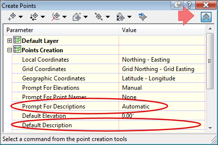

Yeah, it's simple, but not necessarily obvious...
Before creating your points, in the Point Creation Tools toolbar, set "Prompt For Description" to "Automatic", as shown in the attached image. Then set the description you want in the "Default Description" field.
Note that you may have to hit the chevron in the upper-right to open up the lower portion of the dialog box. The default position has the dialog box closed. (This is the part that makes it unnecessarily hard to find this feature.)
