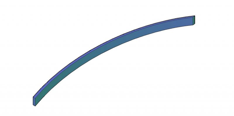

Getting started on a curved stair drawing and having trouble with sweeping and a spline. I've used a rectangle instead of handrail profile because it shows the problem better. Swept object starts out in correct position then twists. Used align perpindicular with different ucs but still doesn't stay in vertical position along the entire path. The pdf is stairs with spline path. The drawing is how it looks after sweep.curved stairs.pdf
spline sweep 1.dwg

Is this kind of what you are trying to achieve?

That is wat im looking for.. every time i try to sweep a handrail profile along a spline it always comes out twisted and hasent maintained its orientation.

In regards to the image I posted. I did not use the Sweep command. I used the Loft command and your spline as a path. I took the profile of the rectangle and placed it at the lower end of the spline in the orientation you have it. I took a copy of this profile and placed it at the upper end of the spline. However, I rotated the profile (did this via a top view) such that it appeared to be perpendicular to the curve of the spline (I "eyeballed" it). Then I used the Loft command and the Path option to obtain the result pictured above.
I tried working with your drawing last night but kept getting the same results as you did. So I gave up. After sleeping on it I came to the realization that what was happening (the "twist") reminded me of a plane taking off on a curve. The plane, in make the arcing and upward ascent into the sky, would have to tip its wings (the left goes up and the right goes down) thus simulating the twist you and I were both encountering. That's why I switched from using Sweep to Loft. Repositioning the upper copy of the profile kept the railing from twisting. I hope all this makes sense. All I know is there appears to be little or no twist in the railing I constructed. Give it a try and see what you think.
Loft, why didn't I think of that? I understand the twist when sweeping because when you physically bend a wooden handrail it tries to do the same thing. You have clamps and a little muscle to keep it straight. Remark comes through again, Thanks
You're entirely welcomed. But let's not be too hasty. I suggest you give it a try and check the results for yourself. I may have overlooked some critical detail.
