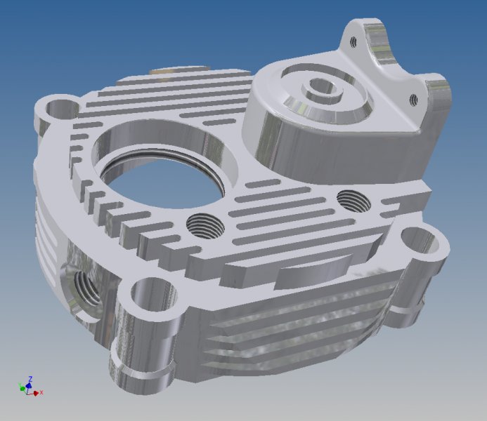

If you still wish to, you can produce a screen shot just by going to the big italic "I" at top left corner of the screen, selecting "export, "then select "image." Now choose what format you want, e.g. bmp, jpg, png, the pixel count and file name and press save. Job done.
Remember that the image will not be as good as it would be using Inventor Studio, but if you go to the "view" command, Inventor 2011 has enhanced lighting and image facilities that are not available on previous versions of the software. You can get a more than reasonble image.
Attached is a quickly produced image using this method. The bottom image is a Studio rendering. I have spent no time at all adjusting lighting for either view. Whereas I could improve the Studio rendering, I cannot do much more with the screen grab.
Regards.
Dave
