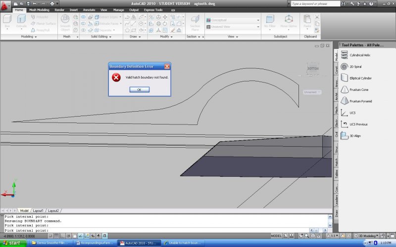

I want to perform an extrusion on the following shape, but I am unable to perform the BOUNDARY command so that I can convert the shape to a surface. It a closed polyline but it still is not working. Can anyone give me any suggestions on how to fix this problem or should I being doing this another way to extrude the shape? Thanks for the help.
Probably is a self-overlapping shape; explode it and start erasing the segments one by one - may found that somewhere you have more entities than you expect. Remove those trouble-maker items, re-create the polyline and try to extrude it again.
By the way, you can extrude the polyline directly, don't need to convert it in boundary.
Regards,
Sweet. You were right, all I had to do was extrude the polyline. Thanks for the help.
You're welcome! Glad to help you.
